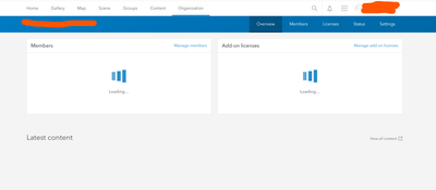

Hello,
I have problem.
I have portal for ArcGIS, and my portal manager is stuck on loading organization tab with settings, overview and members.
it keeps loading.
I have cleared caching, configured new  webadaptor and everything but I cant get access to settings and overview.
what should I do?
Tags (2)
7 Replies
George_Thompson
Esri Notable Contributor
Is the rest of the portal site working as expected?
If not, you may have to restart the portal service when possible (to minimize disruption).
--- George T.
KetevanGigle
everything works fine, problem is just with this tab. 😞
George_Thompson
Roger that. That is a little weird.
It may be something that only a restart of the service would correct.
Are other admin users having the same issue with the same page?
--- George T.
KetevanGigle
I'm only Admin user 😞
I restarted Service multiple times but it was not any help 😞
George_Thompson
Roger, I would contact technical support on this.
Is your deployment fully patched?
--- George T.
KetevanGigle
Yep
KetevanGigle
My solution was to reinstall my portal, nothing else helped
