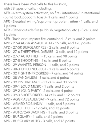

I think you want to use a 'group by' statement in your code, I use this statement to summarize the kind of police and fire calls that are recorded for different properties and display those in a popup, the screen shot shows what the popup looks like
var CallsByType = GroupBy(FeatureSetByRelationshipName($feature, "adapt.ADAPT.AdaptLocationCallDetails"),
  {name:'Department', expression:'BU_SOURCE'},
  {name:'Type' , expression:'CALLDESCRIPTION'}
  {name:'Total',expression:'1',statistic:'COUNT'},
  {name:'Points',expression:'POINTVALUE',statistic:'SUM'}
