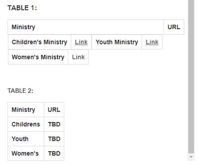

I am having trouble creating a table within a popup that has the following features:
- Selectively shows rows if a custom expression is not null
- Has consistent column width formatting.
How can I get Table 1 to look like Table 2?
Here is my code:

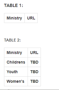

Here is what I get:
Table 2 is formatted well, Table 1 is not; however, it does selectively exclude rows appropriately.
With Row inclusion:
With row exclusion:

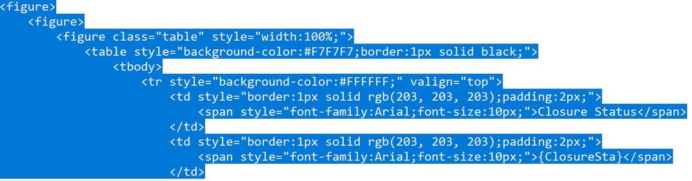

To get tables of the full width in the popup, add "width="100%" within in your <figure class> tag. You'll also probably need to add it within the table style tag, or in your case maybe the <th style> tag. Screen capture of code that works, along with the result is below.
sample HTML code specifying width="100%"sample HTML code specifying width="100%"resulting tables in popup with uniform widths filling the width of the popupresulting tables in popup with uniform widths filling the width of the popup

@jayt70 my bad for not including the actual HTML code that I'm using. The "width=100%" is used twice--first in the <figure> tag and next in the table style tag. Sorry about that. The actual HTML used in the popup displayed is below:
<p>
<span style="font-family:Arial;font-size:12px;"><strong>Status Information</strong></span>
</p>
<figure>
<figure>
<figure>
<figure class="table" style="width:100%;">
<table style="background-color:#F7F7F7;border:1px solid black;" width="100%">
<tbody>
<tr style="background-color:#FFFFFF;" valign="top">
<td style="border:1px solid rgb(203, 203, 203);padding:2px;">
<span style="font-family:Arial;font-size:10px;">Closure Status</span>
</td>
<span style="font-family:Arial;font-size:10px;">{ClosureSta}</span>
</td>
</tr>
rbd

jayt70
Thank you this fixed it!  I was using inline previously and table-row made the difference!
