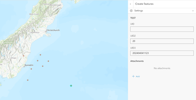

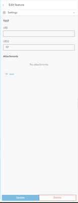

You could use the ( $editcontext.editType=="INSERT" ) to control the field being calculate during the creation of the record but this will still be problematic if you plan on using Object ID. You cannot use the ObjectID during insert because it doesn't exist.
Okay there a few other option we could explore.
1) Calculating ObjectID from the feature layer
Get the max ObjectID from the feature layer and add one to it to get the next object ID.
The edit context type will ensure it only fires when its a new record and since it is a calculated field it will not be editable in form.
if($editcontext.editType=="INSERT")
//do the following only if the edit type is insert
var x = FeatureSetByName($datastore, "TEST", ["OBJECTID"], false)
if (count(x) > 0)
return Max(x,"OBJECTID")+1
else
return 1
else
return $feature.UID2
The first record will be different for the reason that there is no OBJECTID present to calculate the
2) Use CurrentDateTime to get a unique value
If you need a unique number then you could consider creating one out of the date time.
Solution 1 relies on reading the feature layer and I think the number of records could affect performance but with this approach, it will be agnostic of the number of records while giving a unique value. (feel free to add miliseconds to the end if you wanted to be 100% sure :D)
var x = now()
var y = text(x,'YMMDDhhss')
return y
else {
  return $feature.UID3
3) While the above 2 may do the trick, I think the most robust solution would be using GUID function in arcade.
https://developers.arcgis.com/arcade/function-reference/text_functions/#guidguidformat---text
Hope this helps
