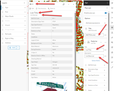

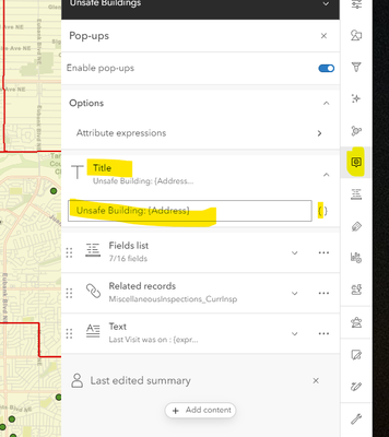

In your popup configuration panel as i've shown below - in the Title area you put in the field you want to show as well as other text you want to add for formatting. You pick the field you want from where the little { } show on the side of that dialogue.

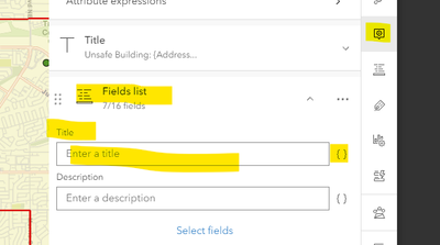

There's another place where the title can be configured in the popups window - under the Field List, you might check there to see if that's been set up independently of the main popup? Its kind of weird in some ways that you can do this but I'm sure there is a use for it.
