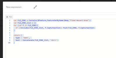

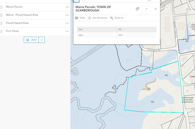

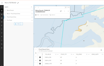

Thanks Ken,  Like last time, in the code box, I see no warningas and it appears to work. However, When I dentifying a parcel, The information shows like there is nothing.  As you can see in the picture,  The property is intersecint zones AE & XS
var FLD_ZONE = Contains($feature,FeatureSetByName($map,"Flood Hazard Area"))
var FLD_ZONE_list = []
for (var f in FLD_ZONE){
  if (!Includes(FLD_ZONE_list, f.Captureaction)) Push(FLD_ZONE, f.Captureaction)
return {
  type : 'text',
  text : Concatenate(FLD_ZONE_list, '<br/>')
I also included the flood layer table in the screen shot for collumn verification.  Im happy to send you the MapService URL but prefer ofver private email.  Thanks again for your help

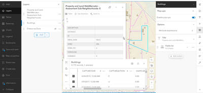

Your code works in testing (using an Arcade element) on my data. I've added the extra check so there aren't any duplicates
var FLDZN = Contains($feature,FeatureSetByName($map,"Buildings"))
var FLDZN_list = []
for (var f in FLDZN){
	if (!Includes(FLDZN_list, f.Captureaction)) Push(FLDZN_list, f.Captureaction)
return {
	type : 'text',
	text : Concatenate(FLDZN_list, '<br/>')
return {
  type : 'text',

No 100% sure what messages are.  I don’t get on these boards much.. Sorry.  But happy to take direction. Feel free to message me or reply a quick how to message you. I changed the "Captureaction" to my attribute column, its called FLD_ZONE see code. The pop up looks like the picture below. and it didn’t actual create a list.. as the identified parcel show "XS" and it should be "XS, AE"1
var FLDZN = Contains($feature,FeatureSetByName($map,"Flood Hazard Area"))
var FLDZN_list = []
  if (!Includes(FLDZN_list, f.FLD_ZONE)) Push(FLDZN_list, f.FLD_ZONE)
return {
  type : 'text',

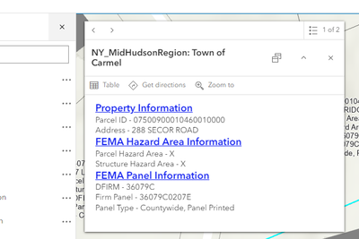

Also my plan is to make a popup like below, not table pop up and actual dynamic one.. I’ve made them before with attribute expression then added then added the expression to a text popup.
