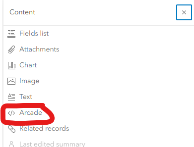

I just revisted and think I got it to work, instead of an expression and a text popup, just add an Arcade item and do all of it there:
add this code:
add this code:

GeoWorld13
@Neal_t_k this worked, thanks!
