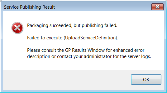

I am having trouble updating an existing hosted feature service in AGOL. When I attempt to publish, I get the following error message:
"Packaging succeeded, but publishing failed. Failed to execute (UploadServiceDefinition)."

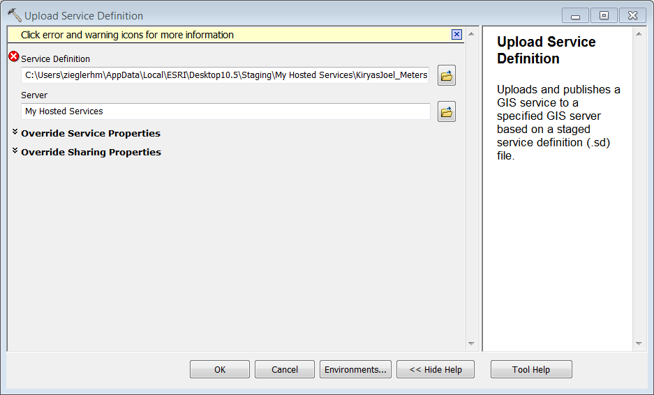

When I go to results, right click the failed process, and click open, I see that the service definition file seems to be missing.
Has anyone run into this issue and how can I resolve it?

HannesZiegler2
Yes, I'm trying to overwrite a hosted feature layer, the service definition file is present in AGOL.
I'm not sure this is the problem, however, because I did try to create a completely new hosted feature layer and I got the same error. I even created an entirely new .gdb, created an entirely empty featureclass, gave it a single geometry and attribute, and tried to share it as a hosted feature service using an entirely new .mxd and I also got the same error message..
