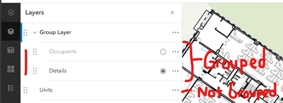

@ABraun The gif in that linked thread is still accurate, but you're next step would be to put your 3 layers into a group. You can create a group by clicking the ... button to the right of any of those layers and choosing "Group" at the bottom of the menu that appears. Expand the new "Group" layer that was created in the Layers panel and you'll see your one layer inside of it. Next, drag the other two layers inside of the group as well (using the six dot handle to the left of the layer name, or you can click the ... button to the right of the layer name again and choose the "Move" option). Sometimes the Move option is easier, as getting the layer to go inside of the group instead of below it via drag can be finicky. You'll know the layer is inside the group if it is indented below the Group Layer row.
Once they are all in a group, click on the Group Layer row and go to the Properties tab on the far right of the screen. Scroll down to the visibility section and toggle on the "Exclusive visibility" option.
The layers in your group will now have radio button toggles.
-Aaron
