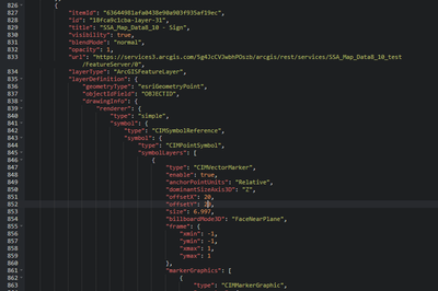

I see that can also be modified by layer in the JSON of the map itself.

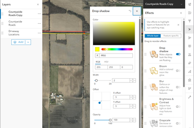

JenniferBorlick
I know this is almost a year old, but for anybody else who is struggling with this, I found something not perfect but serviceable. You can offset the drop shadow. You can't get rid of the OG line and the drop shadows aren't opaque, but it works.
