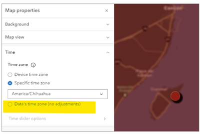

EmilyGeo
You might want to try Setting the Time Zone in the Map Properties.
When you choose Data's time zone, the time will display without any adjustments for device time.
Check out this article for a deeper dive.
