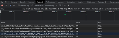

In ArcGIS Online go to create offline map areas. Prior to hitting create, open the browser developer tools and go to the network tab. Hit create.
You will begin to see requests to setup the map area. Then requests to check the update of the job. Look for the repeated request as the map is packaging.

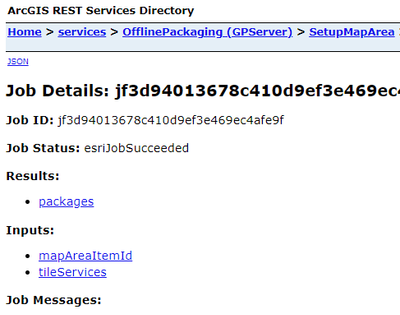

If you open one of these up, and remove the f=json... from the end of the URL request, you can see a more informative update on where job is up to and why it ultimately fails. e.g. URL looks like:
https://packaging.arcgis.com/arcgis/rest/services/OfflinePackaging/GPServer/SetupMapArea/jobs/longjobidstringhere12bdfasdfsasdf
Click on 'packages' to see more on the results. Should give you something to work with. Common reasons you will encounter are:
  • Map has layers added twice. SQLite database does not support this as it creates duplicated table names in the map package. Remove the additional layers and use Hosted Feature Layer Views as necessary
  • The service has transformations that are not supported
 If it's something else like one of the above reasons you should get something more informative. Feel free to post it here. If it's some random issue like a 503 indicating an internal server error, could be tied to a field name, corrupted layer/view or Esri issue. I'd be reaching out to support. Not aware of any reason a layer would fail sporadically unless it's workflow related.
