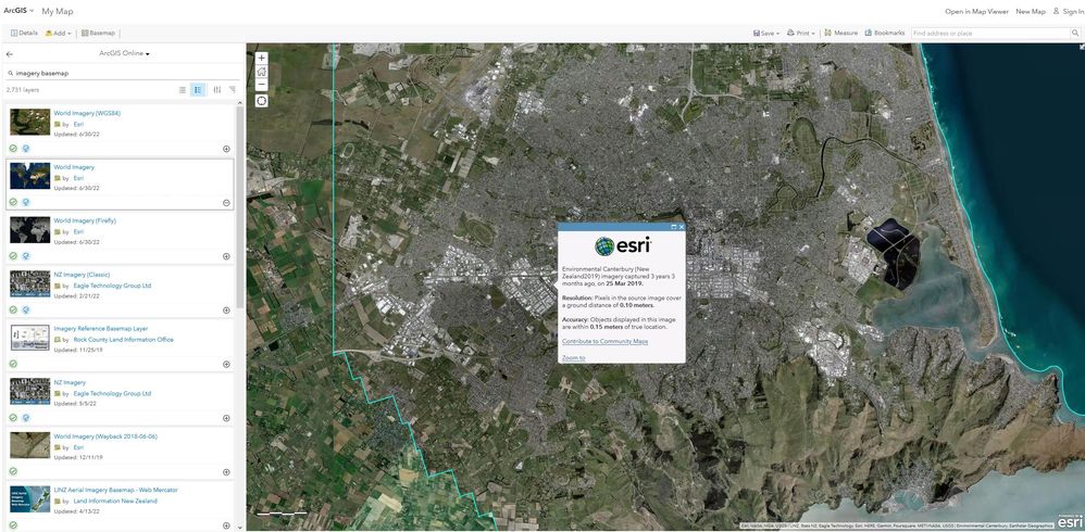

Add the basemap to a map as a layer and then when you click in an area you're interested in, you should get a popup which lists the date of the image being shown. Note: the basemap has to be added to the map as a layer and not selected *AS* the basemap for your map.
