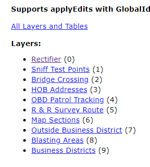

I just went back to input that last bit of code that you had suggested, and noticed something odd myself. In the service directory for the layer we have been trying to get this to work on, it says that the rectifier layer is id:3, but there is no id:0 like I have seen on other maps. see pictures of the service directory for both feature layers:
So instead of referencing id 3 in my notebook, I changed it to id 2 and it worked. The notebook compiled, and the map updated. Why is that do you think? It almost seems like a layer was deleted from the feature service. I didn't make this map, and the new guy that I trained did, so it's a bit hard telling what he may have done haha.

Interesting. I know in later versions of Portal, it's possible to assign unique layer ids to prevent layers from republishing things out of order by mistake. But I also know that other "layers" in the service (relationship classes, for example) can be assigned a number, but as they are not feature services, they aren't exposed in the REST endpoint.
As far as the 2 / 3 issue, that one is easy. FeatureLayer.layers returns a list, and you're just grabbing item x in the list when you access FeatureLayer.layers[x]. So the number doesn't actually matter in the REST directory.
FeatureLayer.tables works the same way. I have lots of layers with a standalone table in them that relate into the geometry. A table might be at the layer index of 5, but if it's the first table in the service, it will be at the list index of 0 when I call FeatureLayer.tables.
