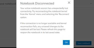

One of my users is having a problem with opening a notebook that I am hosting on ArcGIS online. They always seem to receive a message: "Notebook disconnected: Your active notebook session has unexpectedly lost connectivity....". They have tried multiple browsers and have tried in private tab mode. I personally have no problems accessing the notebook, so I am not sure as what else to suggest.
