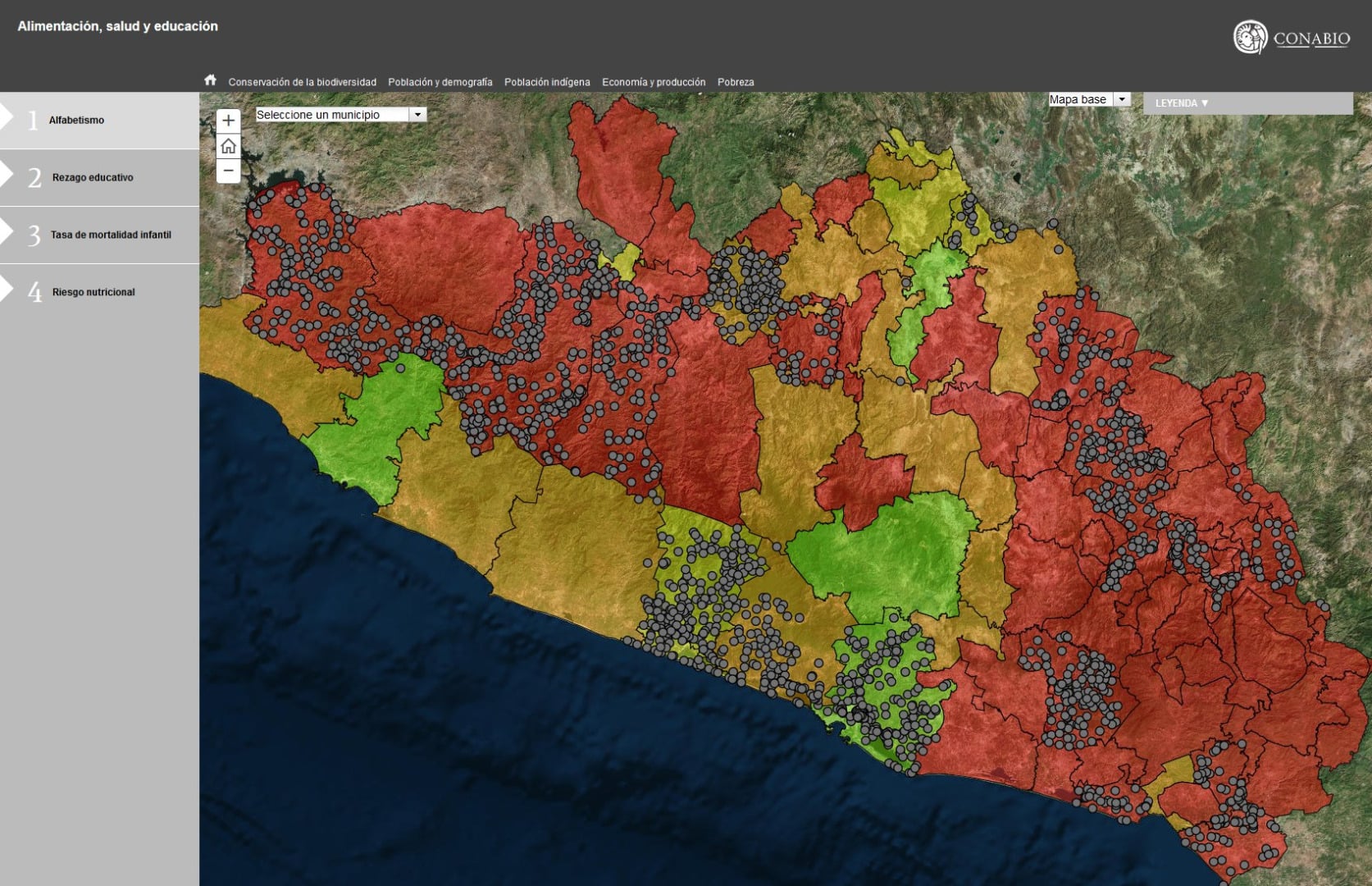

Dear all,
We´re preparing a storymap with demographic data:
http://speck.conabio.gob.mx/cruzada/GRR/As/index.html
Since we have more than 7000 entries for small settlements (>2500 inhabitants), we try to apply a filter (query) defining different ranges of visibility (to avoid visual overload of the map).
Although the filters seems to apply fine, we noticed that just a part (about 2000 points) of a total of 7000 shows up in the map (see figure below).

3) However, for  the last query (if (num == 5){  query.where = "CVE_EDO = " + configOptions.entidad + " AND POBTOT10_E = '1 - 2,499'";     }
) just a part of the points in the feature layer show (see below).
The part of points shown in the map seems to follow an alphabetic order. It seems that the counties are sorted alphabetically, and than point of the first counties are shown, until the list stops at some point.
Is there any limitation in this regard?
Any hints?
