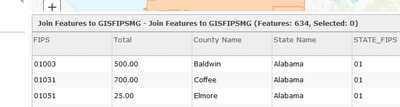

Hello,
I have a csv file containing 634 unique features (FIPS) that every time I attempt to join with a USA Counties layer, the resulting layer has only a random number of features joined (205, 535, 599, etc). I do a 'one to many' join from the target field = FIPS and the join field = FIPS. I can't make sense of why it is not a perfect match, and why the joined features are random. When I make this join on arcmap my joined layer has the correct 634 features displaying.
Please let me know if you have encountered this and how I can fix this issue.
Thank you!
MG

The Use current map extent box is often checked by default. Perhaps that is what's going on here?
When I run an attribute join in AGOL with your CSV and the Living Atlas' USA Counties layer, I get all 634 features in the output.
Also, with a unique input CSV and a unique FIPS field in the Counties layer, you can do a one-to-one join, there's no need for a one-to-many.

It's hard to say if the USA counties is only loading up to a certain limit when the joins have been arbitrary in how many total features are displayed.
I have uploaded the csv being used here. The 'Total' column has been filled with fake data, the join in question was using the FIPS column as is.

Wow, thank you!
It really was as simple as unchecking the box. I was able to make the join with all 634 features displayed.
