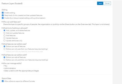

I think you may be on the right path here Ken.
Increase your portal role to ensure you have permissions to create Hosted Feature Layers, and then once you have the created feature layer in your contents you will see additional settings you can control within the portal item.
However in my current version of ArcGIS Portal i do not get an option to export to KML
This may be linked to the version of ArcGIS enterprise I am running and/or AGOL may have slightly different options. If, after you increase your role privileges, you are still unable to export to KML. other options are available:
  • in web app builder you can use the 'Analysis' widget, tick the checkbox for 'extract data' and you can get the option to export to kml
  • in ArcGIS Pro/ArcMap you have the standard geoprocessing tools for conversion to KML
Let me know how you go 🙂

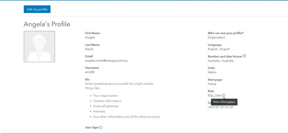

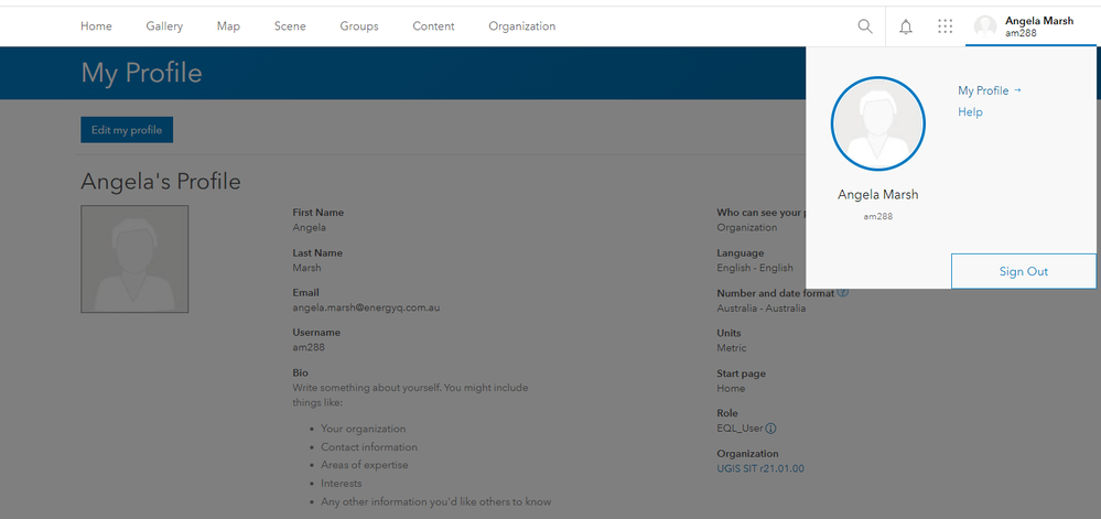

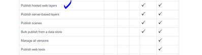

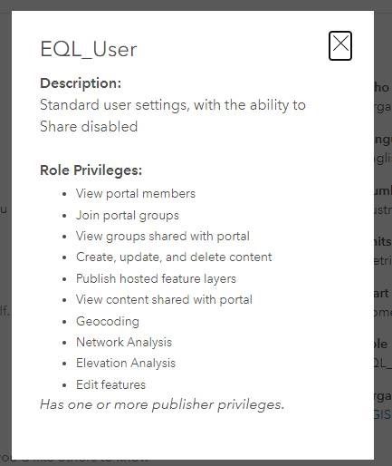

Hi Ken,
you can read some more here: https://enterprise.arcgis.com/en/portal/latest/administer/windows/roles.htm
Roles in ArcGIS Online and ArcGIS Portal have different privileges assigned to them. Lowest role is a 'viewer' who cant create anything, and can only view content, highest role is Administrator which gives you ALL privileges to create and manage content, groups, create custom roles etc. You would need a role assigned to your profile that will allow you to publish hosted web layers.
To see your role/privilege's, you can access this through your profile - see screenshots below.
Go to 'My Profile', and click on the i. next to Role to see what privilege's you have
As you are working as a 'lone wolf' engineer, do you have an esri contact who set you up with your user role and account? you should probably have ArcGIS Online 'credits' which would allow you to publish a hosted feature layer, if you have a role that allows you to do so.
Let me know!
