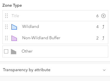

I changed one of the Zone Type domain values from "Non-Wildland" to "Non-Wildland Buffer" (not just label, but the coded value as well. I updated existing entries that were 'Non-Wildland' to the correct 'Non-Wildland Buffer). This reflects fine in symbology....

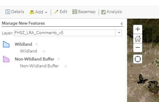

....As well as editing in Map Viewer Classic....

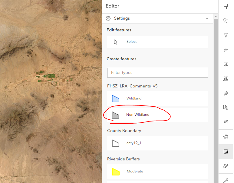

However, the new Map Viewer refuses to honor the change when attempting to edit, and it's not presenting the template appropriately in Map Viewer or Experience Builder.

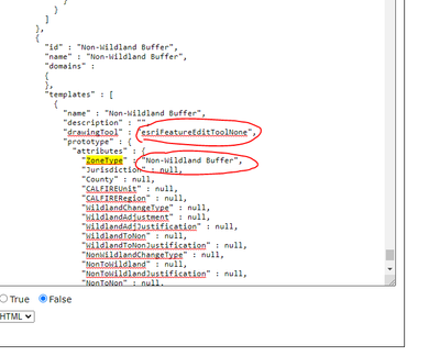

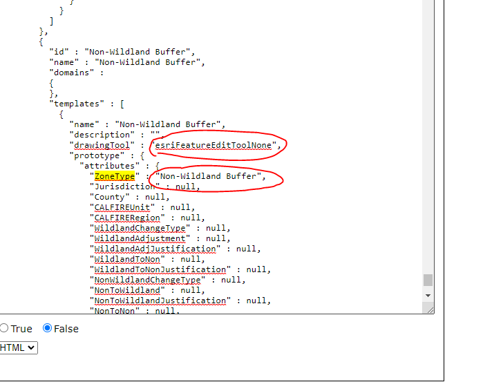

I have gone through and explored the JSONs for the layer and the map and updated every instance of Zone Type being 'Non-Wildland' to make sure it reflects 'Non-Wildland Buffer.' The JSON reflects the editing template as specifying 'Non-Wildland Buffer.' Why is this honored in Map Viewer Classic and not the new Map Viewer?
What gives? And is there a trick to get it to reflect appropriately in the new Map Viewer and EB?
