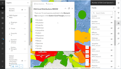

I had to do something similar, where I had many fields, each showing the count of a different species.  Each species field had a name beginning with "MAX_", with the scientific name of the species as the field alias. I only listed the species that had a count greater than 0.
This might be helpful in making your code more efficient, since you don't have to modify it for new building fields, as long as they hold to the same naming scheme. I returned a bulleted list, with the commented out lines showing how to return a comma-separated list with an "and" before the last item.
var theSchema = Schema($feature);
var fields = theSchema['fields'];
var species = [];
for (var i in fields) {
   if (Find('MAX', fields[i]['name']) > -1 && $feature[fields[i]['name']] == 1) {
     Push(species,fields[i]['alias']);
//if (Count(species) == 1) return species[0];
//if (Count(species) == 2) return Concatenate(species, ' and ');
//return `${Concatenate(Slice(species, 0, count(species) - 1), ', ')}, and ${species[Count(species) - 1]}`
return `• ${Concatenate(species,'\n• ')}`;
This expression was used to make this popup
