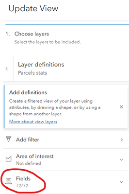

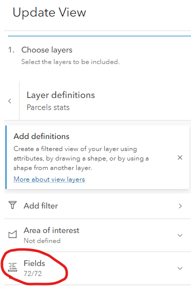

Hi, I recently updated a hosted feature layer by adding several new fields. I would like to update the corresponding hosted feature view layer. However, I could not see the newly addedly fields when updating the view. I followed the steps here (https://support.esri.com/en/technical-article/000017596) but just can't find the new fields in Select Field option.
The 1st snapshot is showing that there are 78 fields in total in hosted feature layer; the 2nd snapshot shows there are only 72 fields when updating view - missing the newly added fields.
Do I miss anything? Any help is appreciated, thanks!

This is a pretty common issue. When you say you "updated" the layer, did you re-publish it from Pro? If so, the view doesn't necessarily see the new fields. You have to add the new fields from AGOL / Portal for the views to see them.
There is a way to add them to the views if you republished the layer from Pro or from a file. Using a tool like the Python API or the AGO Assistant, you can edit the JSON definition of the view to add the missing fields.
