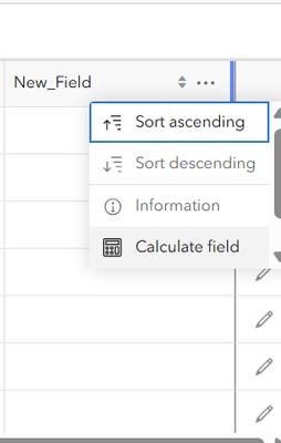

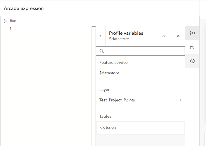

Hi @EmilyGeo, I tried out the Arcade statement in the article you linked, and while it works in a form that inputs the field information when you add new features, it does not update existing features. I think the Field Calculate would actually be necessary, since the users need to be able to see which of the features they create conflict with features in different layers. They want to see that information in a dashboard, as well, but an attribute field needs to be updated in the layer they're working with.
The problem is, Field Calculate doesn't seem to show other layers in the Arcade Profile, so the Arcade expression used in that article won't work. variables.png
Edit: it looks like another user had this issue, and was unable to find a solution. It may not be possible to do this in ArcGIS Online: https://community.esri.com/t5/arcgis-online-questions/calculating-fields-based-on-an-intersection/td...

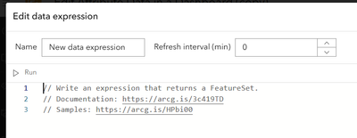

EmilyGeo
Hi @AliciaMcMurchie1
In that case, you might be interested in creating a Data Driven element in a Dashboard
here are the links:
AliciaMcMurchie1
Thanks, @EmilyGeo , I'll take a look! This seems promising.
