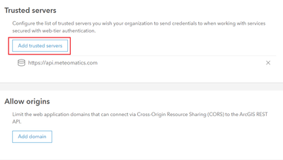

If that doesn't work, add the Server URL to ArcGIS Online > Organization > Settings > Security > Trusted Server.
Have you tried the above steps?

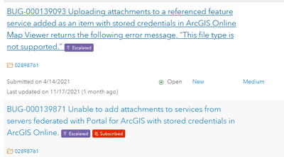

We have experienced this bug for over a year and from have the latest portal, we have been told its being worked on for all this time from Dec 2020 to Dec 2021 now. Spent many many days with esri support on this one, still an open bug against AGO. To be clear this is when you have secure services running on an enterprise portal then using AGO to create an item with stored credentials to that service, editing will work but adding attachments will fail to the service.
