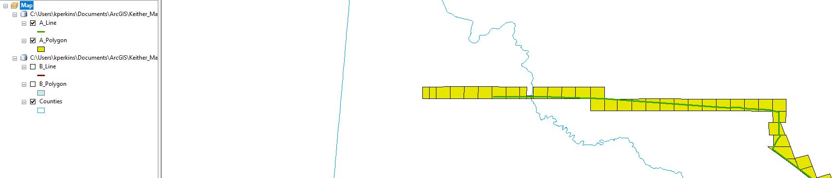

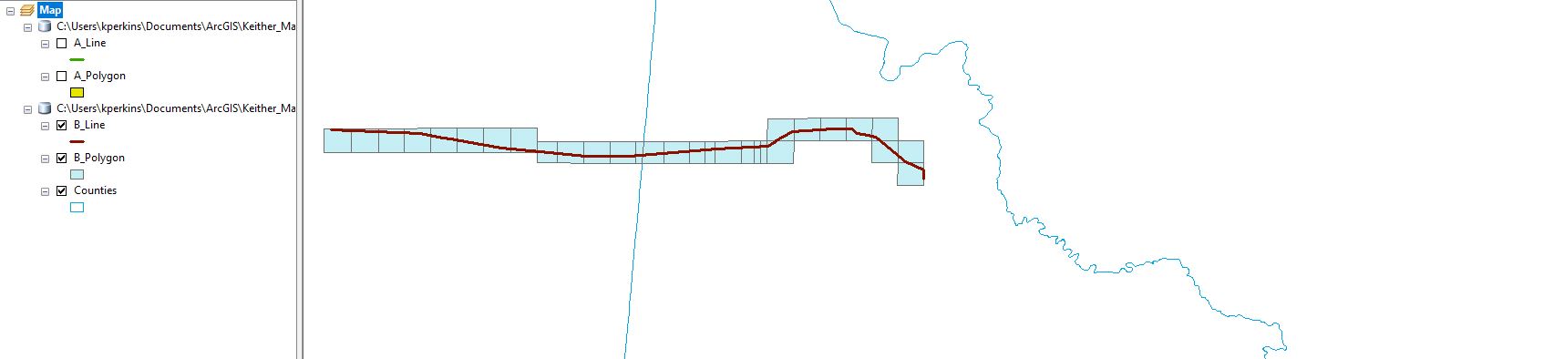

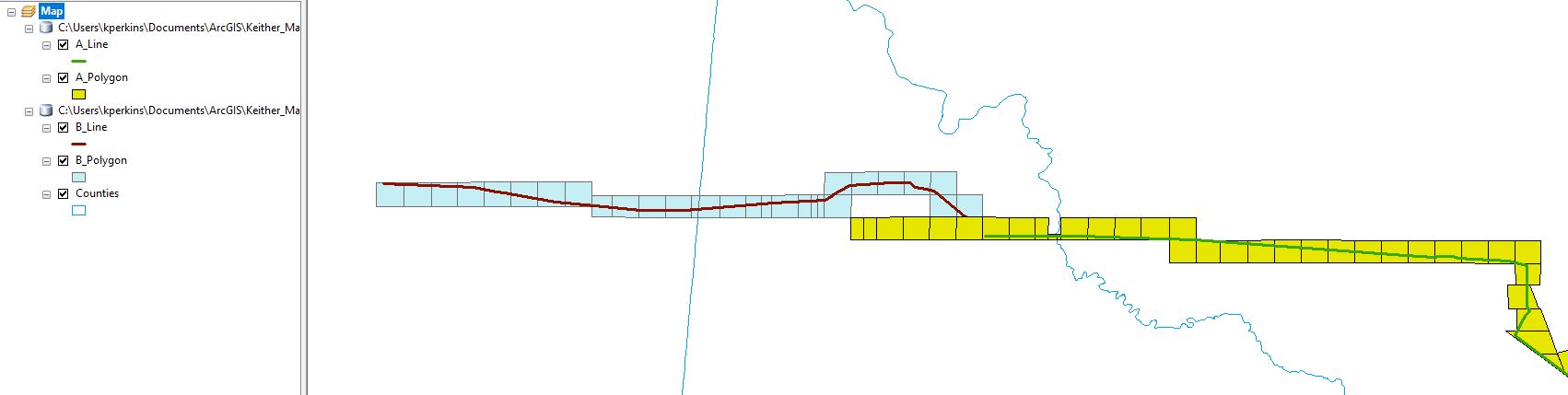

I am trying to create a webmap with several layer groups, where each one hold points, lines, and polygons. I want these to be able to be viewed together, but also separately and independently, as needed.
For example... I have a main Line. It has features along this line that can be viewed and edited. Eventually I will build a lateral line off this line that will have the same features but may need to be isolated for viewing purposes.
I imagine showing in the 'Contents' window like the example above, but would like to toggle all features from one line on and off as needed to show the following...
