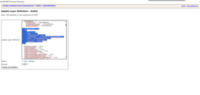

I've attached an image showing what these relationships look like within the layer's definition. The keyField property contains the foreign key information you would want to update. Once again, because this workflow is unsupported, there is very little documentation available. My assumption is that if a relationship can be added or removed by adding onto the service definition, it may also be possible to modify an existing one in the same way.
The most relevant information I found on this was in an older Esri Community post where a user successfully added a relationship using this approach. One important detail they noted is that the changes had to be made to the definition of each individual layer rather than to the service definition as a whole.
