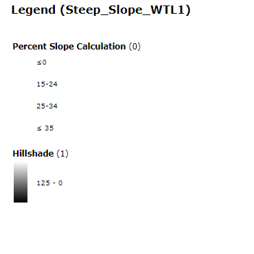

I've exported my Scene from Pro 2.5 to an online web scene. I have a clipped area of hillshade and slope analysis along with my other features. Everything is in the scene correctly, but my slope raster classification colors are not showing in the legend, only the labels. Is this a bug or can this be fixed?
BenAllamong1
I did have a slight transparency on. Exported it back into Online and that fixed it.
Thanks!

The legend being displayed is matching the service level
Are you using any transparency on the tile layer when publishing?
BenAllamong1
Thanks!

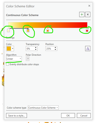

I ended up on this page as I was having the same problem, uploading a raster from ArcPro using the Share as Web Layer tool. What was crazy, is, the day before I had uploaded using the same steps some rasters that have a transparency at their lower end and they all displayed correctly...
But this thread got me playing around with the colour scheme and weirdly what resolved the issue (and it could just be gremlins in the system as this made no sense to me) was to ensure there where 4 inflection points and the algorithm was set to linear for all sequences as shown below...
I could then set the mask to say say display zero values as nothing.
