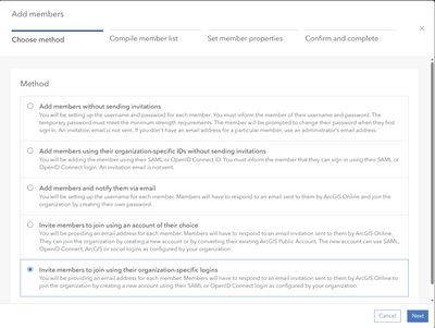

  • When you have a SAML login configured and enabled, you will see some new options for adding users. One of these is :
    • This lets you send an email to individual users, or any number of users via a list (CSV) with the fields of Email, Role, and User Type, that you can specify.
    • The user gets an email with a link to basically log in with only the SAML login option and you can pre-configure the Role and User Type with CSV, or, individually, you can go ahead and configure the normal new user options for Add-On licenses, groups, etc.
    • However, after you invite with this method, the user account doesn't automatically show up in the Members list. The user only shows up after the user logs in. So I'm not sure how much that helps besides just notifying the user that they should login. You would still have to transfer content, assign groups and licenses if you didn't already, etc.

Good find!  I hadn't found the "transfer member".  I'll have to look at that a bit more.  Like you, I also found the additional "add member" options once activating SAML.  I've tested "invite members to join using their org specific logins"... this worked fine, but like you indicated, you have to wait for them to login to do anything (assign groups, permissions, etc.).  I also tested "add members using their org specific ID without sending invite" - that actually worked really slick.  I created a new user using this method, and followed the naming convention used by our SSO.  Once created, I used scripts to set role, license type, and group assignments based on the pre-existing user (the user is a field editor, so no owned content to transfer).  This worked very well.  This way I was able to do what I needed to, not needing to wait on them, and they didn't need to wait on me either.
