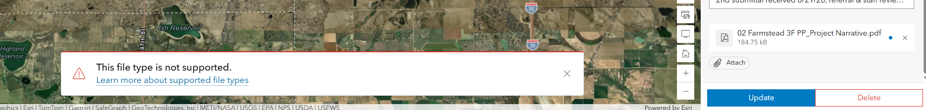

Just wanted to see if anyone else is running into issues with uploading PDF's or any document at all to their layers in Map Viewer. I've tried pdf, jpg, xls, and a few others and I always get This file type is not supported. All of them are well under the 10 mb limit.

@NathanGabbard we've tracked down the issue you were seeing. There's a bug in Map Viewer, where Drag and Drop for Attachments in the form is not working. Using the file browser, i.e. clicking Add File, should work for you and I believe it does.
We're evaluating if we can address the Drag and Drop issue for Attachments in Map Viewer for this release.
