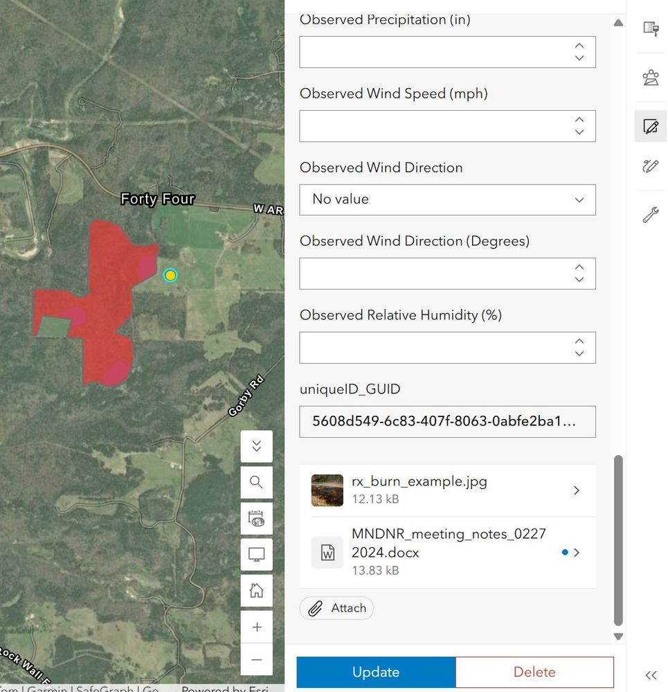

No I didn't make any changes, just using the default form. I was testing on this layer, editing within this Map Viewer edit interface (screenshot shows a second attempt where I successfully added a word doc)
