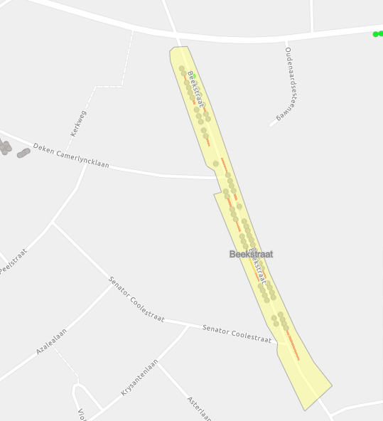

Hello Everyone,
i am trying to set up a pretty basic map in arcgisonline, but for some reason i can't get it right.
The map contains some polygons, in the mapviewer everything shows up as how i intended it to be.

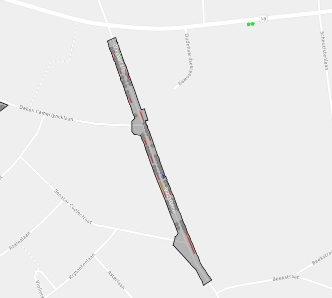

Once i use this map to create an app, all of the polygons turn out grey.

It looks like the map you are using probably has the symbology stored in it which will define the styling vs. what is at the layer level. Can you use experience builder or instant apps which will support how the symbols are stored? Older clients apps are moving into retirement as we are working towards retiring the older API they have been built on.
https://doc.arcgis.com/en/web-appbuilder/latest/create-apps/wab-retirement.htm
