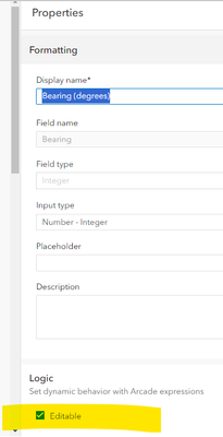

In the Classic Map Viewer, popup control was a one stop shop, users had control of field visibility, alias names and editing. Specifically, users where able to have independent control over which attribute fields were editable in Feature Layers (see attached screenshots). That level of control appears to be gone from the New Map Viewer. Popup control has been broken out into separate popup and field management panels and neither appear to offer any editing control. Now it appears control of attribute editing is all or nothing - all fields are editable or no fields at all are editable.

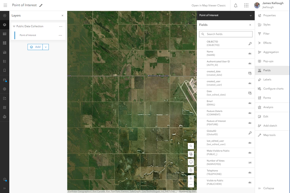

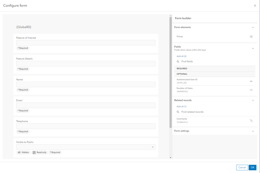

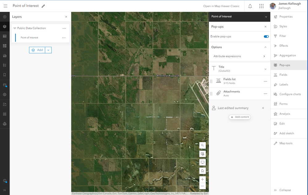

Thanks for the suggestion to use forms in the New Map Viewer, unfortunately it did not work. Perhaps this web map feature, like some others, only works in ExB and not legacy apps? I've included screen shots of the web map popup, fields and form panels configuration as well as the Crowdsource Reporter App data submission form showing the fields that I excluded in the web map form. I guess I'll stick with using Classic Map Viewer for use with this legacy app for the time being.

Popup Panel
Fields Panel
Form Configuration
