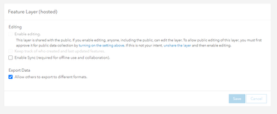

WindsorConnecticut
Go into the detail page for the layer. > Settings >Feature Layer (hosted). Then enable others to download the data in different formats.
