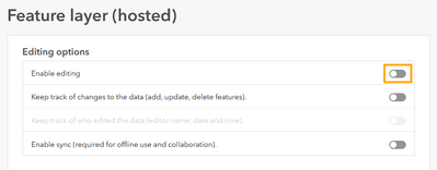

DebapriyaPaul
Hi @AnnaRoberts98, there are a few great suggestions in the comments above!
If you have published a Web map to ArcGIS Online that you would like to embed in your public website, we would need to disable editing specifically on the Feature layer being consumed in the Web Map.
  • Open the item details page of the Feature layer
  • Click on the Settings tab
  • Disable editing
Please let me know if you have any follow-up questions!
