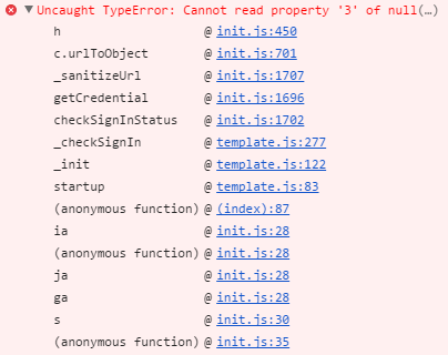

So I've begun (what I fear will be) the (laborious and excruciatingly painful) process of propping up a locally hosted GeoForm for the Events Permit Solution.
I've created the Events Permit AGOL Webmap.
I've shared it with EVERYONE.
I've configured the GeoForm with the web ID.
It spins when I load it... and the Console error says:
Any ideas? I'm completely lost.

I cleaned up the default.js attribute 'sharinghost' to point to my arcgis portal and now I'm getting:
Unable to create map: A valid layer to create the GeoForm was not found. If the GeoForm has been configured with a layer, the layer may no longer be available, or authorization failed.
So lost...
BrianO_keefe
Honored Contributor
Ok... I had to go into dev tools on Chrome in order to get the Layer ID. Once I did that... it worked. Putting 'all' did NOT work.
