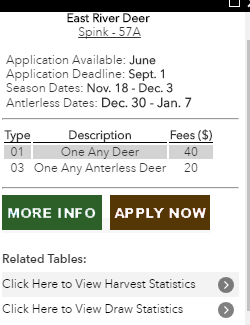

Thanks for the Ideas! We are creating a Hunting web map so users can click on Hunting Unit and the popup contains the general information about that hunting, but what if the user wants to see Draw or Harvest statistics? That where we would want to link to another pop-up, but I think I found that using a related table gives me the same effect. See Below.
The only part I wish could change would to have it now show the 'Related Tables:' part? is that possible?

Currently it isn't possible to embed a related table within another pop up. There are some apps that will show the related table as a table in the app like crowdsource manager: https://www.arcgis.com/home/item.html?id=43a4a0dbf9914f93bf0657f7839fa655
Additionally you can show attributes of a related record in a pop up with your other information: Configure pop-ups—ArcGIS Online Help | ArcGIS
