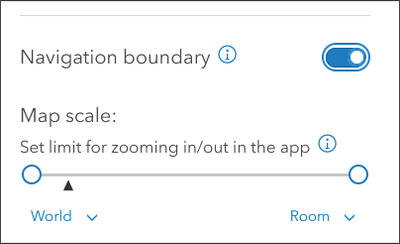

There isn't a built-in setting in Map Viewer to do that, however using Instant Apps you can set both a boundary and a scale.
