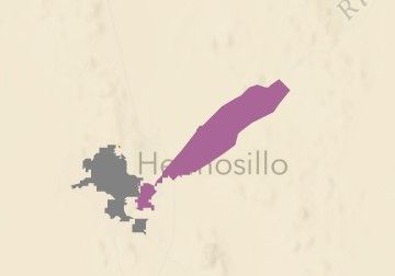

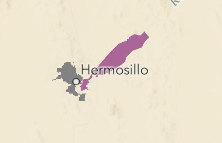

Hi all. I'm having a very vexing issue with displaying an ArcGIS Online Web Map inside of a Web Mapping Application (webapp). My original map has, from bottom to top, a tile layer base topo map, several polygon feature classes, and then a tile layer on top that just contains labels from Esri's topo map. In the Web Map (in new Map Viewer), this displays perfectly, with the labels on top (first photo). But when I put this web map into a web mapping application, the display order changes, and suddenly the labels are beneath all the polygons (second photo). All the webapp does is create a shell that references and displays the web map, so why would it change the order of the layers? How can I fix this? It really doesn't look readable unless the label tile layer is on top.

Correct, label on topCorrect, label on topIncorrect, features cover labelsIncorrect, features cover labels

alex_vanko
