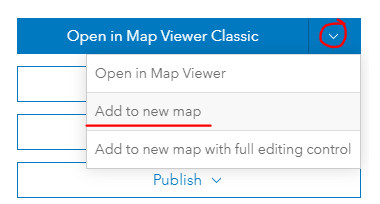

Hi @LynneSabourin , yes, the default behaviour is to add to the current web map (with the current web map being the last one you had open). You need to click on the drop down arrow on the right, select Add to New Map:
