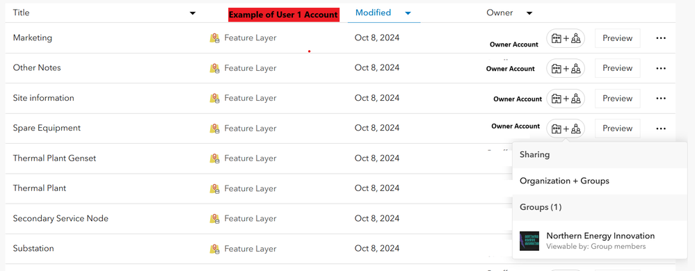

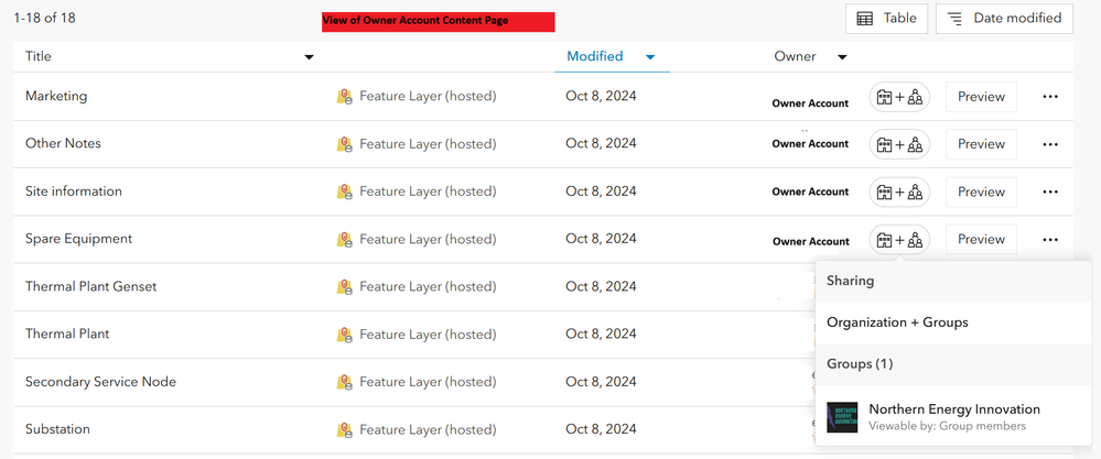

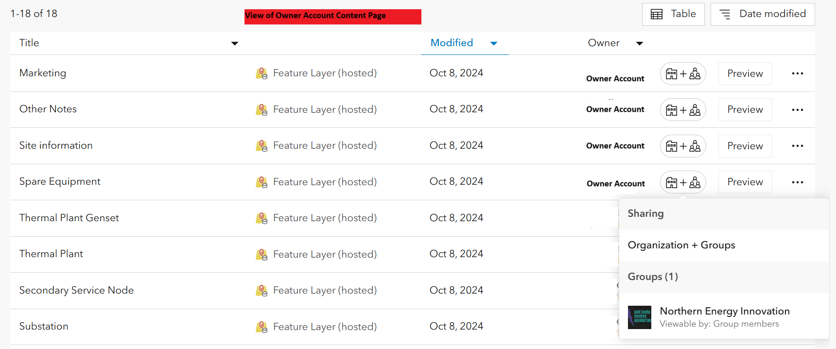

Hi there, having difficulties with sharing privileges of our ArcGIS online Layers that are shared in a group and owned by a member. I would like it set up so any member of the group has equal privileges to the layer as the owner does. in the example layer below you can see the top menu within the layer does not show all permissions as seen by the owners view.
Owner Content page, and sharing:

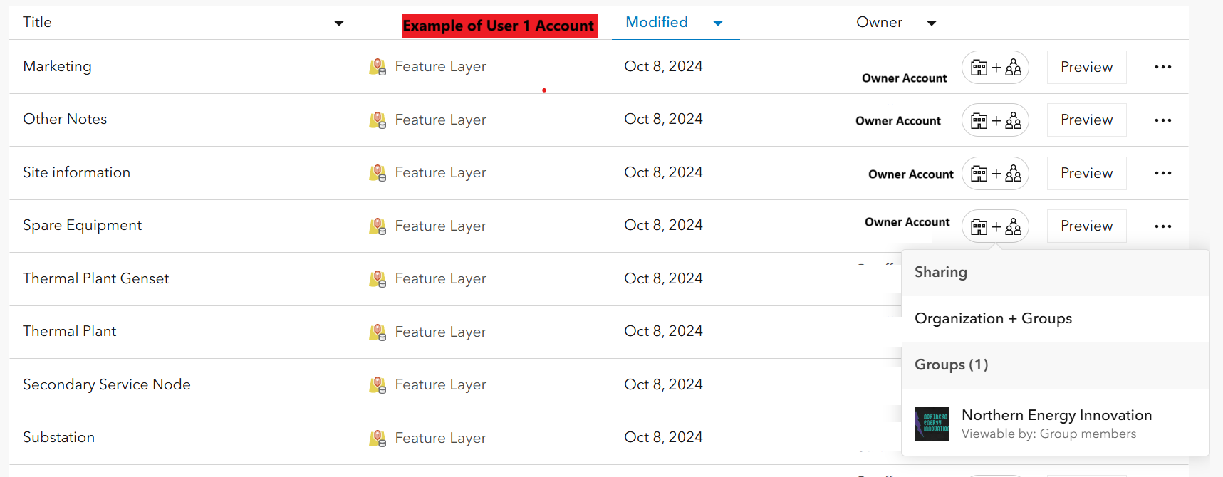

User 1 Content page, and sharing:

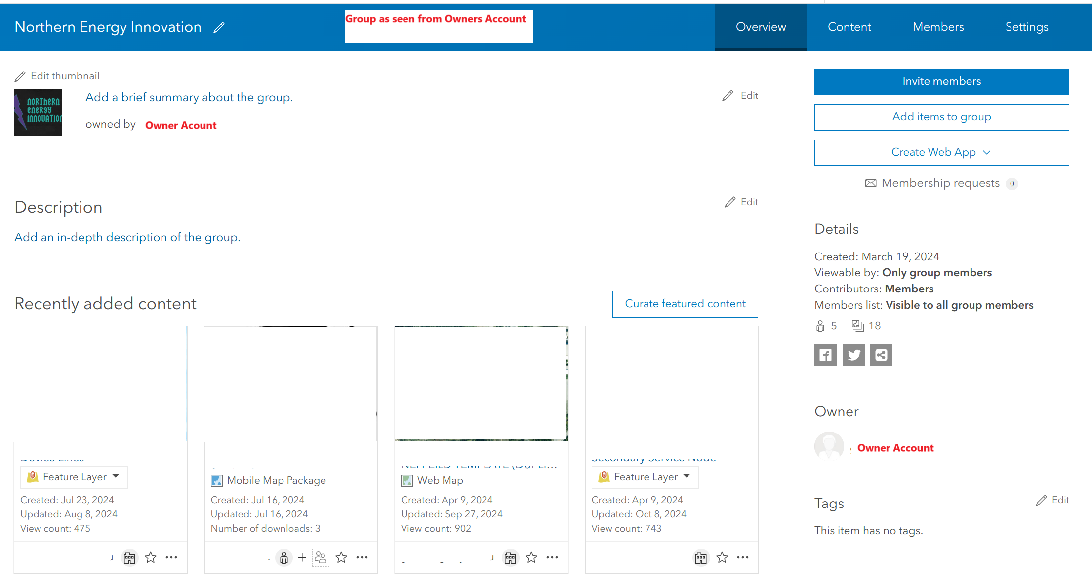

Group Details as seen from Owner Account:

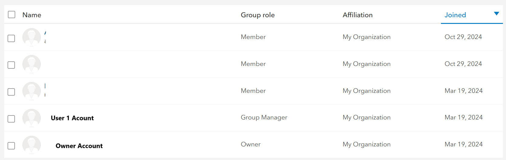

User Setup of Group:

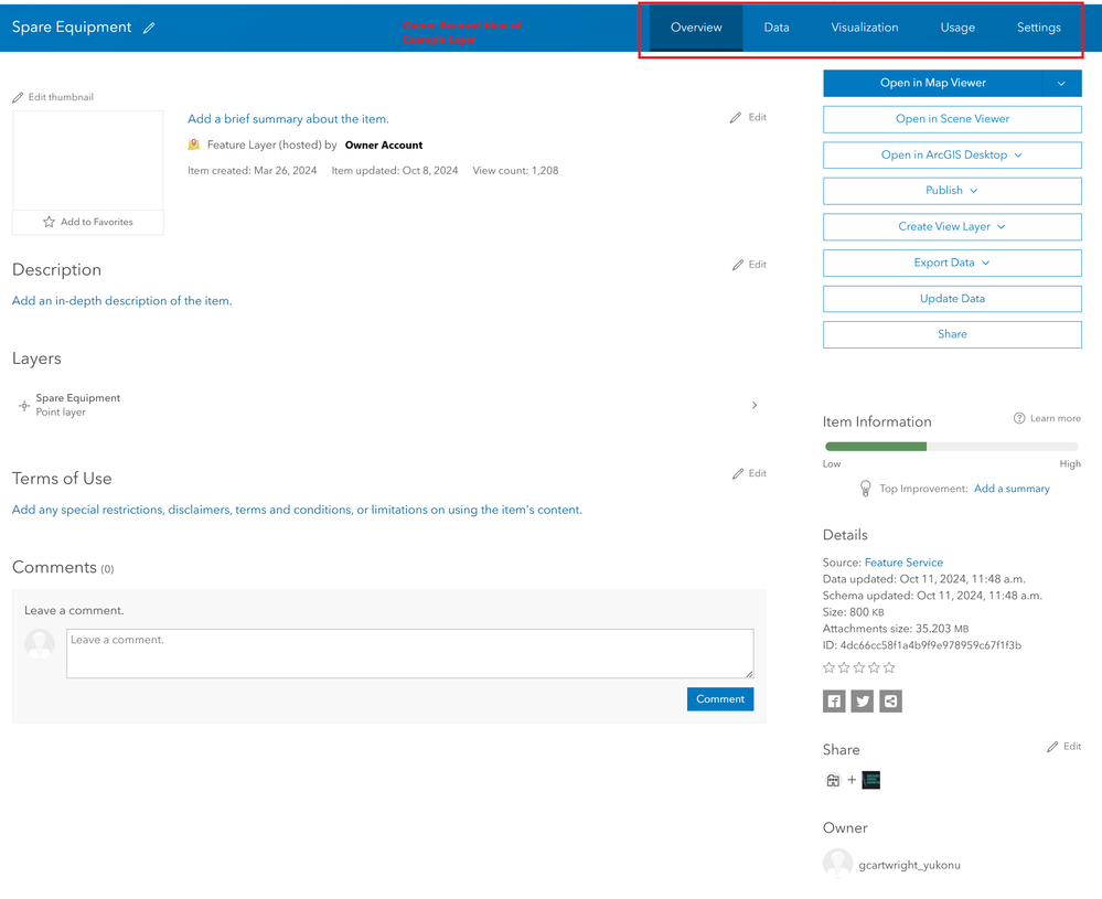

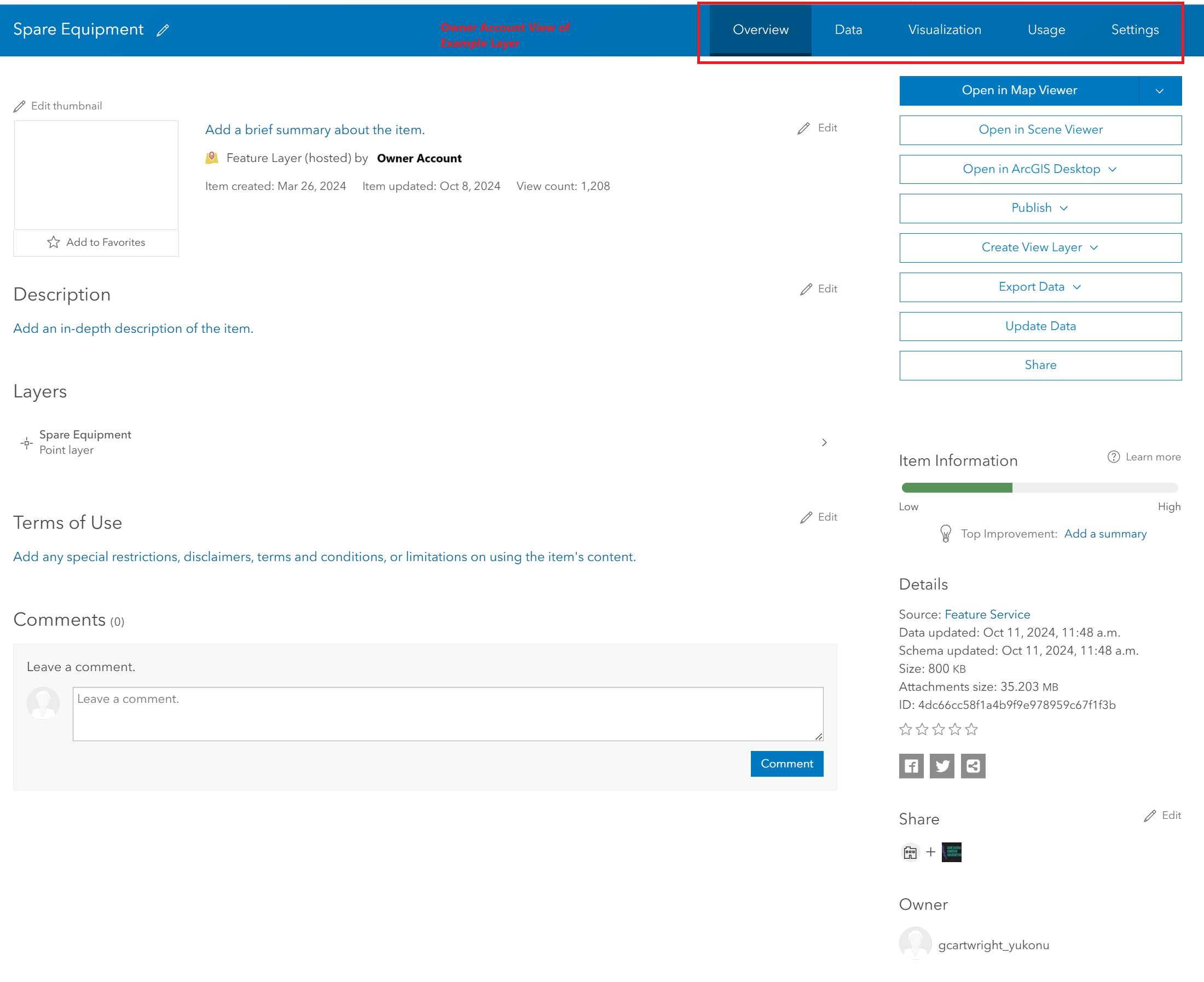

Example Layer from Owner (box of settings missing from user highlighted):

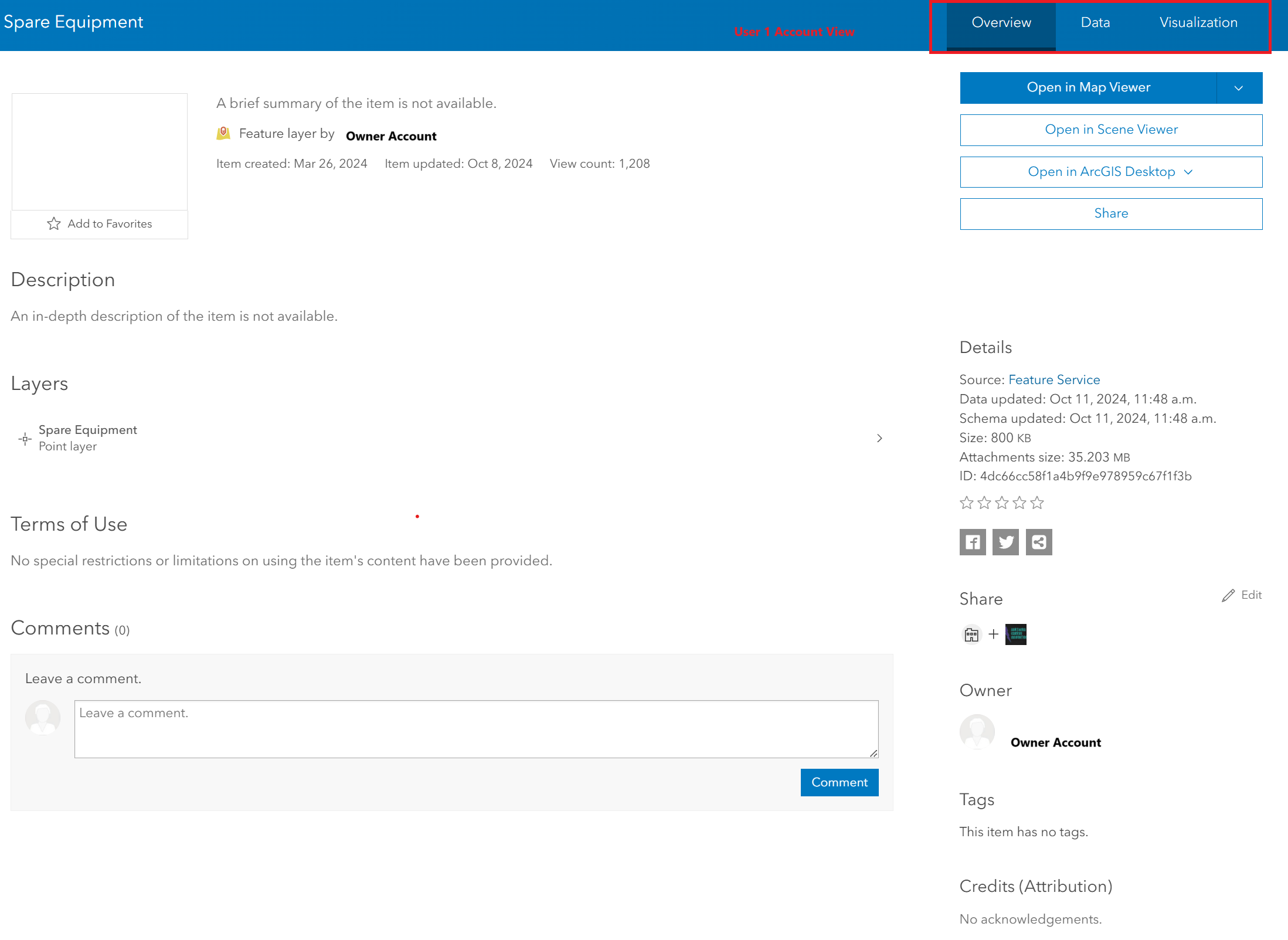

 Example Layer from user 1(missing editability outlined):
This user can have full permissions without any restrictions. Any help would be lovely. Sure it is a easy fix but no matter what I set things to it seems not to work.

Only the owner of the layer or an org admin can change the settings of a layer, including editing access.
https://doc.arcgis.com/en/arcgis-online/manage-data/manage-editing-hfl.htm#ESRI_SECTION1_C30D73392D9...
