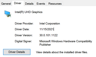

Do you know the update driver version?
MillionMap

@MillionMap that appears to be the same driver version as posted in https://community.esri.com/t5/arcgis-online-questions/labels-are-flashing-blinking-in-map-viewer-and...
Maybe the computer needs a restart? Or it's possible that the manufacturer for your device hasn't updated the intel drivers if IT is only installing those provided by the manufacturer instead o intel directly.
The latest intel drivers for your machine be found here: https://www.intel.com/content/www/us/en/products/sku/203682/intel-core-i910885h-processor-16m-cache-...
The latest version is 31.0.101.2127 which came out 2/1/2024

Thanks for checking so quickly te1945. I didnt catch this in previous posts - what version is your intel graphics driver.
te1945
Version - 10.0.22621.3235
