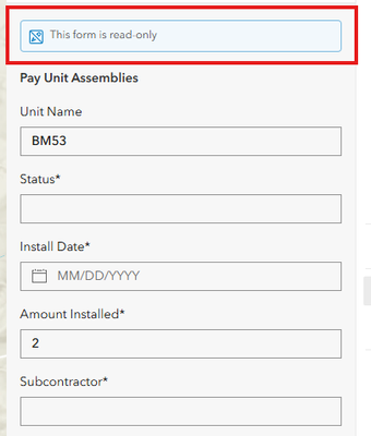

Thank goodness for this thread. I hope ESRI takes this seriously, I'm putting in a ticket now due to the fact that our related records in web map viewer are now read-only and we can't figure out how to fix it. The telling part is that in Field Maps they are fine, still editable, no issues. This update has caused us to put in so many extra hours fixing things that were working just fine prior.
