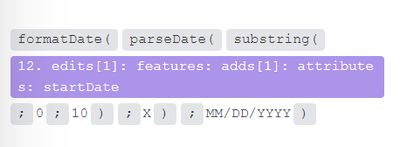

I'm generating an email on an added feature in an AGOL hosted feature layer.
Along with other attribute data I'd like to include a date from an attribute field in the email.
Currently, I'm getting this in the JSON:
"startDate":1804105800000,"endDate":1804116600000
How can I convert this to human readable in the body of the email?

The solution to formatting this kind of date properly in Integromat (now Make) is as follows:
Thanks to an old post from an AnonymousUser for this solution:  https://community.esri.com/t5/arcgis-survey123-questions/webhook-emailed-date-issue/m-p/794129/highl...
