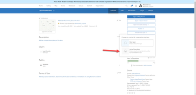

Hi @esriuser12345, are you using Map Viewer or Map Viewer Classic to create the join?
If you are using Map Viewer, the option to create a Hosted Feature Layer View Join, which is what will make the layer update dynamically as the source data updates, is not available in the Join Features tool in Map Viewer. Instead, there's a new way to create a hosted feature layer view from a join, located on the item details page of your target layer. You can check out the documentation here and this great blog post about the new method.

Yes, the steps in the video are outdated. You should instead follow the instructions listed above.
