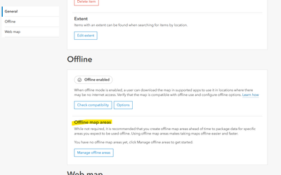

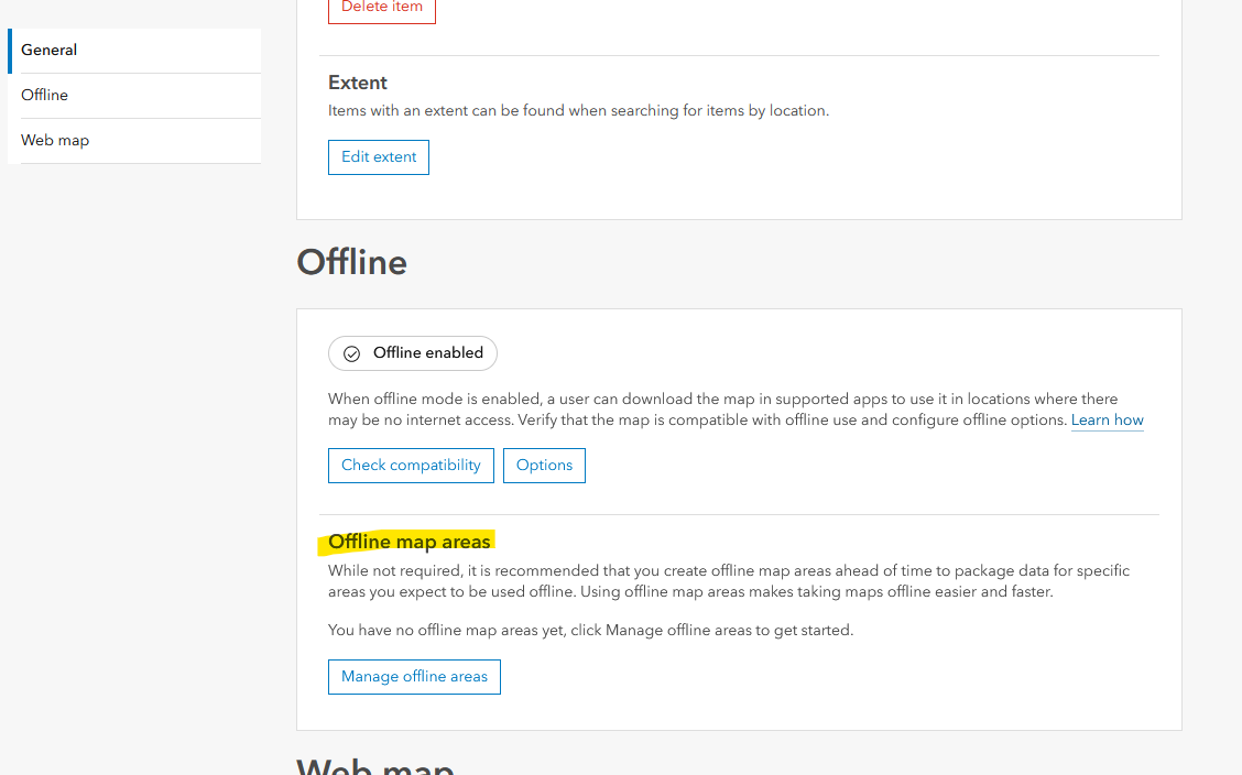

I am trying to find if there is a means of programmatically determining which Map Viewer within my ArcGIS Online organization has Maps that are currently set to package map packages. I need to run through and stop some of these maps that have this functionality set up for them. I provide a screenshot below of the area that I am talking about.

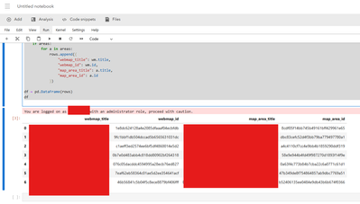

@MichaelBruening - You can use a python notebook in AGOL.
Run the below code -

You should see a list of all webmaps and the areas associated with them.
