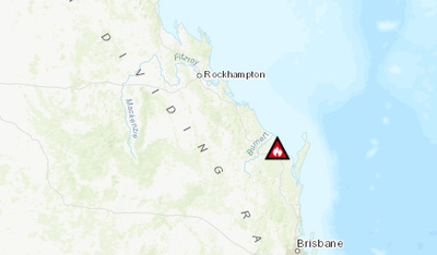

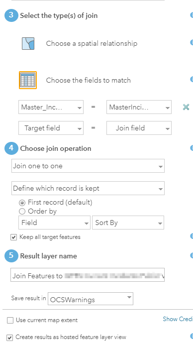

I have two hosted services and I'm performing a field join on them and creating a hosted feature layer view.
Both services are dynamic with the data changing regularly.

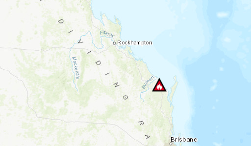

I use "Keep all target features" and even though my target layer currently has about 15-17 features it only returns the one matching feature.
Any ideas?

Could you check if the issue persists when you
1. add the corresponding layers in a fresh webmap, and try Join once again.
2. Clear cache or try Join in a different browser

PeterKT
Thanks, that worked.  I'm really surprised it did.
It seems weird that's what was stopping it working.
