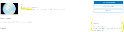

A quick way to tell if it has an associate feature layer is by looking at the item details page:
Second is checking if the url for the scene layer
services.arcgis.com - means the scene layer was published from a feature layer
tiles.arcgis.com - means it was published from a scene layer package.

Thank you for your response. I have checked my scenelayer and it appears exactly as the image you posted. Evidently the scene layer has an associated feature layer but the JS SDK thinks otherwise, so I believe this might be a bug or something else is afoot.
