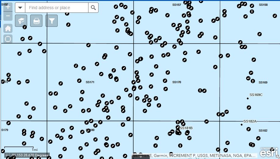

I have a large dataset that I don't want to be visible on startup of my web map. I only want the results of a Filter or Query expression to show up on the map once the filter or query has been requested.
In this map, the black dots with white arrows are part of the historic dataset and I would like the map not to show this on startup but only on filter or query.

Hi James,
Try setting the visibility range so that  layer doesn't draw at small scales. Ensure that the data is visible at the resulting scale. Check out this Minimalist app as a sample:
https://webapps.maps.arcgis.com/apps/Minimalist/index.html?appid=8eed999928d34ca68c2c1a2a9ae308ae
This is the source web map:
https://webapps.maps.arcgis.com/home/webmap/viewer.html?webmap=b9dec521521b4a528b1127a1276eee42
-Kelly

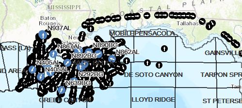

    Kelly, Thanks for the help. I'm new to all this and kinda learning on the fly.
    So not sure if it is considered hosted or server but this is what I have. We are tracking aircraft and we have a provider that is ingesting the data from the different tracking providers and then producing 2 different sets of data from that. Current Asset Position and Historical Asset Positions.
    So now with that, I am working on making custom Web Maps for users. My end user, in this case, needs to be able to run a query or use a filter to be able to isolate a historic track or tracks from a previous day/times flight. This is why I don't want to visually show the historic track because it is so much data and on a regular basis of just looking at the map they will just want to see the current position of the asset.
    Below is what it looks like close in with the history visible. The square blocks are 3 miles square.
    I will try and take a look at the Filter configurable app to see if that is something they have provided me with and or if it would work in this situation.
