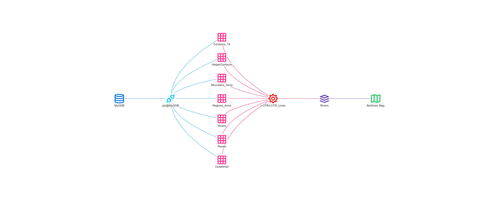

Hi @DerekPhyn sorry to revive an old thread. You mentioned you tried Qonda Reports, Im interested to know to know why it didnt give you what you needed? If you look at the attached images the diagrams show dependencies from a web map and layer perspective - and you could also create a report to do the same in a textual way if required. Just trying to understand if there was something Ive missed or If I could do it a better way!
