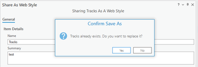

What version of Pro are you using?
with ArcGIS 3.0 there was a fix that went in and you should get a prompt when you have a desktop style file and you share from Pro with the same name you should get the warning prompt a style already exists.

MappyIan
Thanks @RussRoberts, we're still using v2.9.3 of Pro.  That's great that there is the ability to overwrite in 3.0. Thanks for the prompt response 👍.
