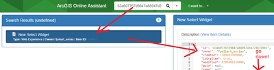

1. write down your AGOL ExB Portal itemID
2. go to https://ago-assistant.esri.com/ , login to your AGOL
3. Select I want to .. view an Item's JSON
4. search for your Experience Builder portal item id
5. Click on the result > there are two (2!) JSON paragraph appearing on the right
6. scroll down to "data" and click "copy JSON"
7. open Notepad and paste your JSON ,  save as "config.json" in your  C:\ArcGISExperienceBuilder\server\public\apps\0  (thus overwriting the existing config.json)
8. Don't  forget to also overwrite the twin copy in C:\ArcGISExperienceBuilder\server\public\apps\0\resources\config
 (note that app /0/ is used as an example : the best is to create a blank project in ExB and replace that one)
9. Fix the config.json so that widget verions match with your ExB Dev Edition (I strongly recomment to get the very latest ExB dev edition
 otherwise there will be some serious hacking that involves peeling onions and crying.
10. Re-run ExB Dev edition : and try re-opening that hacked project
DO BACKUPS
and don't forget there are 2 identical copies of config.json that must be maintained (one is draft and one is the "published" version)
This may not work on all widgets and for all versions - do some tests.
